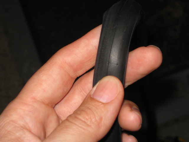

    This is so educational. Without this board, I would have bought a new tube and called it a day. OK, Oakleaf. What do you think? It is a double puncture, almost like a snake bite! I ran over something and heard a "pop." After checking my tire, I have 2 small cuts--but they don't seem to correspond to where the tube would have been cut.

    That is a pinch flat, in fact they are often called snake bites, because of said resemblance. It was likely caused by having too little pressure in your tire (though a really sharp blow can pinch flat even a tire with good pressure) and unless there is another unrelated problem with the tire you do not need to buy a new one... Small cuts are fine, somewhat larger ones can be repaired with super glue, but if you have a really big cut or a cut in the sidewall, it is likely time to get a new tire. Other reasons to get new tires - excessive wear or flat spots, sun damaged/ cracked rubber, especially in the sidewalls.

    Thanks guys I sat down and looked at my tire for the first time, very closely. I'll pay more attention
