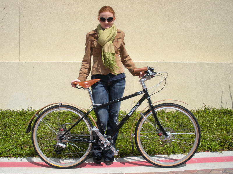

    Hey ladies Welcome Miss Cherry, my new and awesome commuter build. She's a Surly 1X1 w/ custom cherry wood fenders, beautiful Nitto bars, and a B17 Brooks Saddle.
    Now. I know that the B17 is a men's saddle but on my road bike I run a women's 140mm bontrager racing saddle, so I figure my sit bones are nearly narrow enough to ride a man's saddle. I am just not comfortable on the new bike. I feel like I need to sit up quite straight in order for the saddle to feel right (and yes, the nose is up but thats what the shop says is normal w/ a brooks) and that means I end up reaching too far to get to the bars and am ending up w/ a little back/neck pain. Boo! I already have a stubby little short stem on the thing and don't think we can mess w/ that much more. We've tried moving the seat forward with not a lot of effect.
    Ideas? Different saddle maybe? Longer bars that come back towards me more?

    First, that looks great and can we have a close up of the fenders?
    I'd say level the saddle for one and just give it a shot. It may be standard to tilt it upward - but it's your bum & other parts that are on it, so do what feels good for you.
    Handlebars that sweep further back towards you might help.
    Something that sometimes helps me is putting a longer higher angle stem on bikes, so maybe try different stem angles and see if it sits you more upright.
    You can always switch saddles on the bikes for a little bit and see if you like the geometry better with your usual saddle.

    That seatpost looks like it has a bit of a setback on it, you could try a straight seatpost.

    I second leveling the saddle to start with. While I do ride my B72 with the nose tilted up the tinniest bit, I've never seen anyone's Brooks with the nose tilted up that far. The neutral position for a Brooks is with the nose to mid section level, then make tiny adjustments from there.
    I'll try to see if I can find the old thread where it's explained better.

    Ah, here it is!
    http://forums.teamestrogen.com/showthread.php?t=14348
    If you're interested, there are many other informative, and often entertaining, threads to be read about the subject by typing in "adjusting Brooks" in the search box.

    Fidl,
    I've got pics of my surly pacer commuter build on page 1 & 2 on here (It's not as classic of a build as yours is):
    http://forums.teamestrogen.com/showt...t=29170&page=2
    I used a 16 degree 120 mm stem to basically lift the handlebars way up high. At some point, specialized had stems with little pieces you could swap to change what angle your stem's at, and I bought a couple of those to use for sizing stems, and then buying the one I need. I still have that stem on the bike (sure, it's heavy but...)

    You do have a short stem, but it has a pretty good rise to it. How about a negative or 0 degree rise at the same length? I'm saying this cause the handlebar seems higher than the seat. I would not recommend this usually, cause most people are dealing with a bar that is lower than their seat, but you are dealing with one that is higher. It could help, but perhaps not; I would try to borrow a stem like that from the bike shop to see if it would work. Our bike shop always has old stems around that you can borrow to try out fit. I would definitely drop the nose of the saddle to see if it makes it better. You can always move it back up.
    The seat post suggestion of a straight seat post is a good idea too, but I would try one thing at a time.

    As usual, you ladies are AWESOME! Thanks especially for the very informative link. I tried to search TE for applicable postings but there was just too much information for me to sift through.
    It seems I'm going to try a B66 or 67 since I aim to sit quite upright on the bike. It means I'll have to order another saddle but thats OK. Any advice anyone? I can't seem to figure out the differences between the B66 and B67...hrm.

    First, the shop is just incorrect about Brooks saddles- they should not have their noses poking up into the air- your tilt looks uncomfortable to me. Start with setting it level as a starting point and then make very small adjustments over time. Putting that nose down more level might help your problem- try that first.
    Second, from the photo, it seems your swept back bars are locating your handgrips pretty darned back close to your saddle already. If it's just the upright-ness making you uncomfortable then get a normal stem, not a riser stem- perhaps the same length (in MM) but not one that tilts up, raising your bars. Something like this Nitto stem perhaps (but your size): http://www.rivbike.com/images/produc...2/50-038-6.jpg
    That would bring you down a bit. Not sure what bars you have there, but Albatross bars are quite back-sweeping.
    You should keep in mind also that often when we make a drastic change in our biking body position it can feel weird and sore at first, then start feeling good after a few weeks of riding, as our body and muscles adapt to the new position.
    Personally, I would not go with a straight seatpost if it's going to move your saddle up to where it shouldn't be and might throw your weight/center of gravity off balance too far over the crankset.
    B66 & B67 are both Brooks saddles with springs under them- are you sure that's what you want? Springs do add weight and make attaching a back saddlebag a bit more tricky. Some women like sprung saddles but I don't find I need them at all even though I ride pretty upright on my two bikes.
    The diff between 66 and 67 are the rails underneath- double or single, and that depends on what kind of seatpost you have and what it requires.
    The main consideration in ordering a Brooks is knowing your sitbone width- best to have this narrowed down before ordering too many saddles. I have about the widsest sitbones there are and I ride a B68 Brooks. I used to ride a B17 and that was great but a bit too narrow for my sitbones. Sounds like (and looks like!) you are less wide than I am for sure.

    Oh how pretty! I 2nd what everyone is saying. Start level. I actually use a book with a level on it and am most comfortable when the brooks is level. Others tilt them up SLIGHTLY. Your tilt looks uncomfortable to me too.

    If everyone's suggestions don't help, then don't be afraid to try something else. Brooks aren't comfortable to everyone.

    I think your saddle is tipped too far back too.
    Yes- not just tipped up, but it looks all the way back on the rails. Try moving the saddle forward a little. You might want to check KOPS (knee over pedal spindle) with a plumb bob. Run a string with a weight from the bump under the knee to the pedal, with the cranks horizontal, on the forward leg (while seated normally). The neutral position would have the string bisect the pedal spindle, through the ball of your foot. That is a good starting point, some people feel more comfortable slightly back from that point or slightly forward.
    Changing this will affect saddle height- you may have to raise it a little if you end up with the saddle forward of where it is now.

    Is it just me or does the saddle look a bit low in relation to your legs as well?
