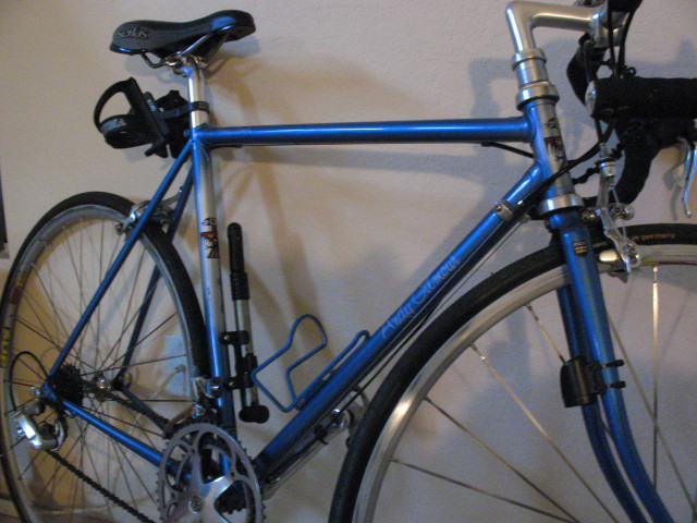

Keep in mind, she is 12 years and 50,000 miles old. This is a custom bike. It is Reynolds steel & C-Chorus.
