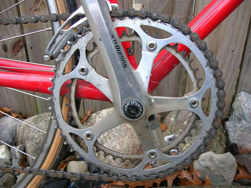

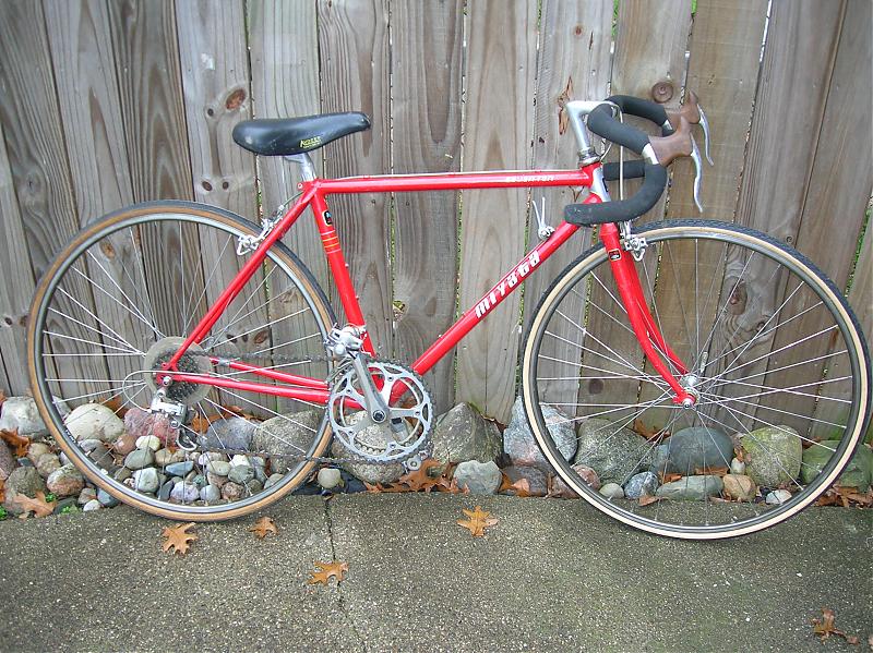

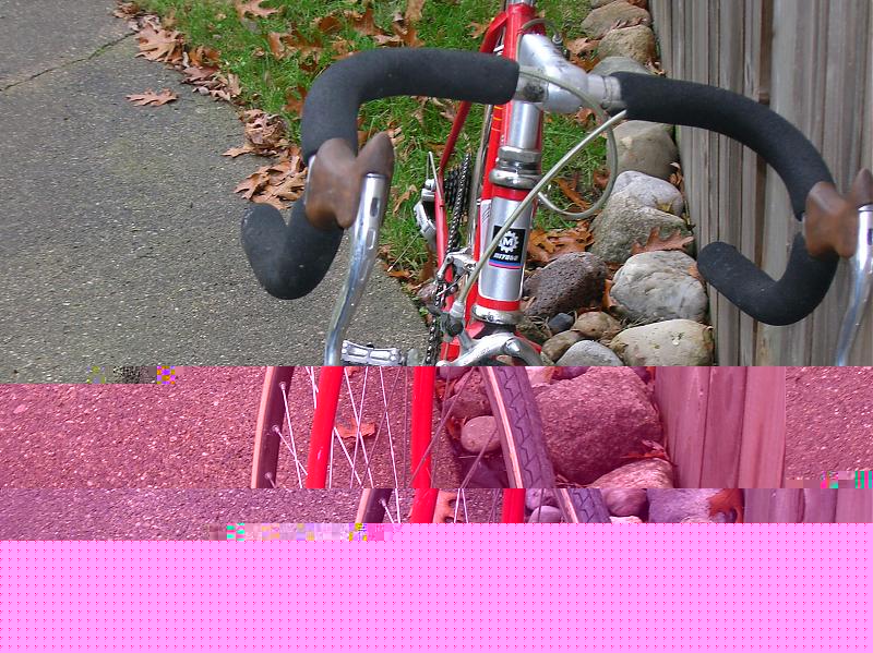

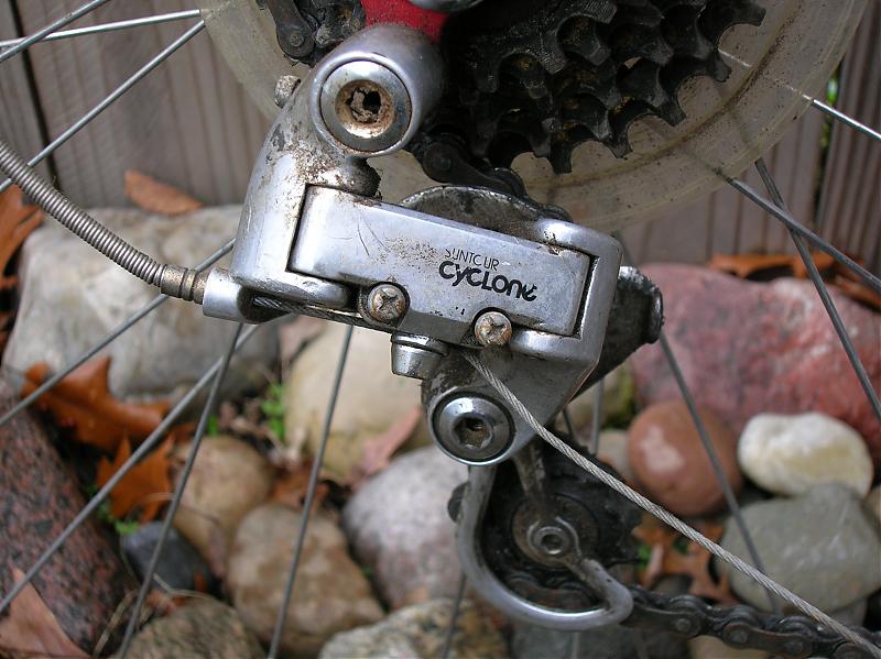

    Pictures of the (old) new ride!
    Here are some pics of the Miyata 710 I just bought. I took a lot more pics than this for anyone who wants to see more close-ups of certain parts.
    I'm trying to decide on handle bar tape and bottle cage colors - any suggestions? The logo is silver, so I thought about matching that, but not sure. I think I'm going to get some tires from Performance. I was thinking about some Continental Ultras because they have some for pretty cheap right now. Should I go with 23s or 25s for this bike?
    I'll probably start working on the bike in about 2 weeks when I have more time. I'm planning on doing the anti internal rust thing and then also re-lubing the bottom bracket as well as doing a thorough cleaning and eventually getting rid of outer rust spots and paint chips (I'll need to find some touch-up paint). My experienced bike building friend said he thought the wheels felt solid and probably do not need new bearings at this point. After looking at it, he thinks the bike probably didn't get ridden a lot, but just sat around a lot. He also said that he doesn't think we'll need to replace the chain right off the bat if it's not skipping. ????
    I'm new to this stuff, so if there are more great suggestions, please send them my way. I'd like other opinions besides the ones my friend is giving me. He has sort of an "old school" way of doing things, which is cool, but I'd like all kinds of perspectives. Thanks again!!!!
