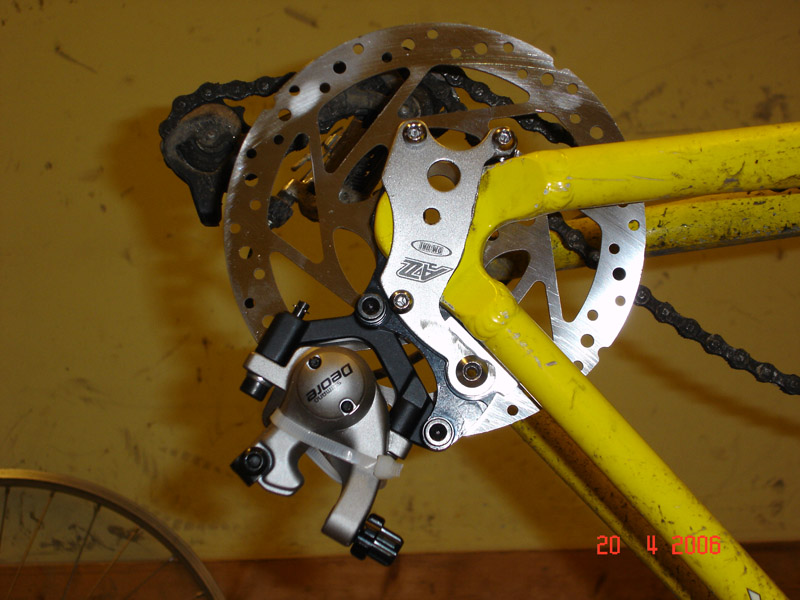

    project finished
    Picture is a bit large but this is the way he finally did it with the part he bought from ebay
    so thanks again for the hint..

    Wow I have never seen anything like this before. There sure is a lot going on there.
    By the way looking at your picture you are in need of some new jockey wheels and that chain sure needs a good clean.
