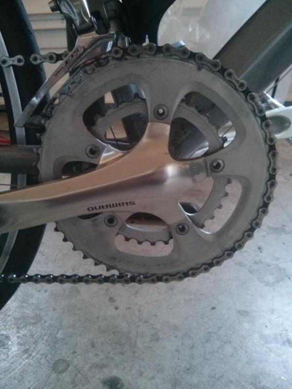

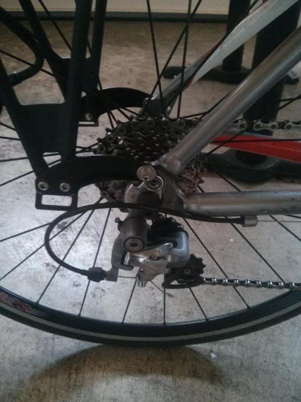

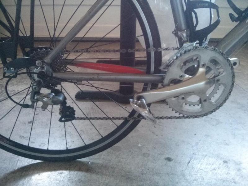

    The Terry Tailwind is from 2011 with the shimano 105 group set. There are two chainrings in the front.
    Little one has 34t and 50t in the big ring. hopefully I didn't look at it incorrectly. 10 cogs in the back. It has 165mm cranks.
    Sometimes I'm spinning in the big chainring when I'm on flats.
    I don't have a bike computer that calculates my cadence either.
    Hopefully these photos help.

    I've had bikes with both 650 and 700 wheels and there was no noticeable diference in my speed. When you are talking about "spinning," it sounds like this might be more of a gearing issue than what size wheels you have. I am a natural "spinner," in that my cadence is always high, I never stand or mash the pedals, and I tend to use the easiest gear I can, to give me the speed I want. But, you might feel that you need a gear that is in between the ones you have on the rear cog. When this happens, you can feel like one gear is too hard, but the next lowest one has you spinning like crazy. I felt like this when I switched from a triple to a compact double; there's bigger jumps in the gear ratios on a compact. I learned to get used to this by using the harder of the cogs and getting used to that. Four years later, it's not an issue and both my bikes have this kind of gearing. It sounds like your Terry has similar gearing, so you might try experimenting with using slightly different gear combos.
    I think maybe a cadence sensor might be a good idea, either that or just use a watch or computer with a seconds display, and count your cadence when you're in a safe, flat place and spinning at a cadence that you feel is "out of control." Everyone has a "powerband," a most efficient cadence range, that's different for everyone - but on the other hand, learning to pedal in circles rather than squares, is a neuromuscular skill that can improve with practice. It's one thing if you feel like you're out of control at 130 rpm ... a completely different thing if it's 70. Especially since you're feeling out of control in your big ring on the flats - and on a track bike, which are typically geared pretty tall - that suggests that you're pedaling inefficiently at a rather low cadence.
    Make sure your bike is properly fit - that can make a huge difference - and it's certainly possible that even the 165 mm cranks are too long for you, which is a dilemma since it's very hard to find anything shorter. Me personally, I can't ride anything longer than 165 without causing both knee and Achilles tendon injury, besides it being much harder to spin, and I'm on a 50 cm frame (though that's a little bit large for me, and my tibia/femur ratio means I tend to need shorter cranks than most people with my overall inseam length).
    Try looking up drills and form cues for pedaling efficiency. A couple of easy things to do are just simply visualizing pedaling in circles at a comfortable cadence, try to sense and eliminate any hitches or "angles" in your pedal stroke. Downhill intervals are a great drill - get to the top of the hill without working too hard, then coast down while pedaling in whatever gear allows you to just keep tension on the chain. A cadence sensor would also let you do cadence intervals on the flats - just spin up as high as you can without bouncing for one minute, then rest, then repeat.
    Equipment issues are important, but don't overlook the neuromuscular issues.

    Oh hahaha, I think the cross chain looks like that because I shifted to count the teeth on the chainring.
