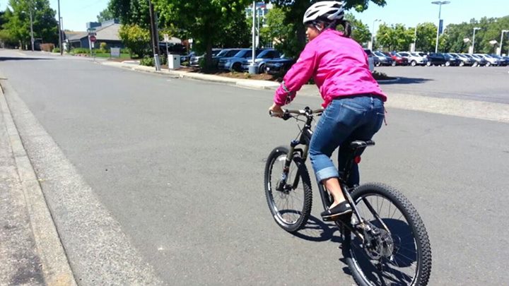

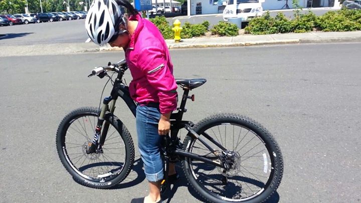

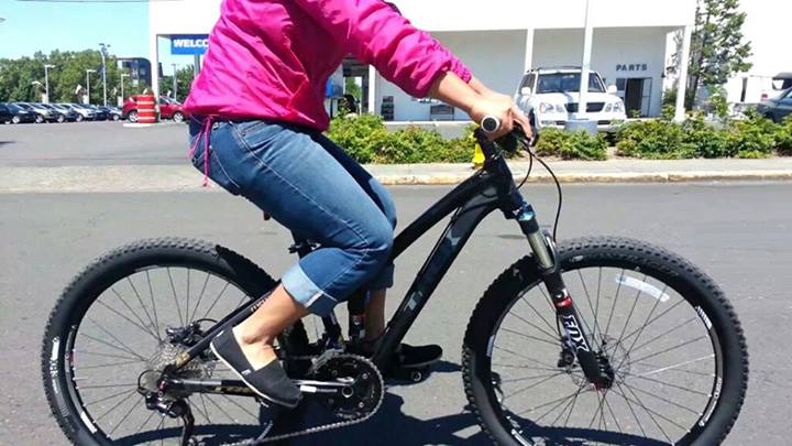

    during a test ride.

    Quote Originally Posted by amyp View Post
    during a test ride.
    It looks like you have very little standover room. Ideally you should have a couple of inches of clearance.
