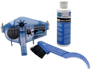

    I use this kit and love how it works. There are videos online for it's use and also reviews. I was working on my bike in the late winter in my brother-in-laws garage because it's heated and has hot and cold running water and he was very skeptical of the contraption when I pulled it out, but was really impressed with the results. After drying, I lube with T-9 and shifting is smooth as silk and quiet.
    When using any degreaser on your bike, avoid getting it on the frame and wipe off and rinse if you do.

    Bike Writer, I have seen that blue contraption on YouTube. Is it easy to use? I'm all thumbs, you see. If you recommend it, I know where I can get it for a reasonable price. Thanks for the tip about degreaser on the frame. For the frame I'm going to use a rag/sponge and soapy water plus Q-tips for those hard to get areas. I know a lot of people use hoses, but I don't have one in my apartment! It'll have to be an old-fashioned bucket for me and little by little so I don't soak my living room, which is where I keep my bike. I get the feeling I'll end up making a mess though despite my best efforts
