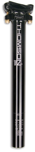

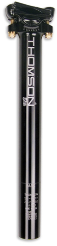

    Actually, getting the hips and knees over the pedals correctly is a very important adjustment. At first you can slide the saddle rails fore-aft on the current seatpost's clamp.
    If you need more range you can change the post for one with a different "offset." Offset simply referring to how far behind the post the clamp is located. See attached offset and "zero" offset pics
    Normally a stock road bike works best with a moderate offset post. 10-20mm
    It is not recommended to use the fore-aft adjustment of the saddle to adjust the reach to the handlebar. Muirenn mentions distance to the bars increasing with saddle height. True. However, from a fitters perspective, what the higher post is actually doing is sliding the saddle behind the pedals....the reason for running a zero.
