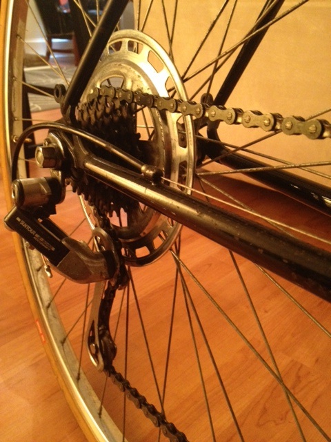

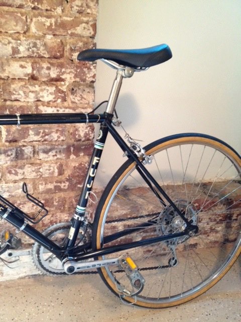

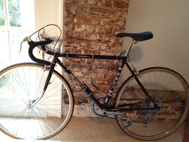

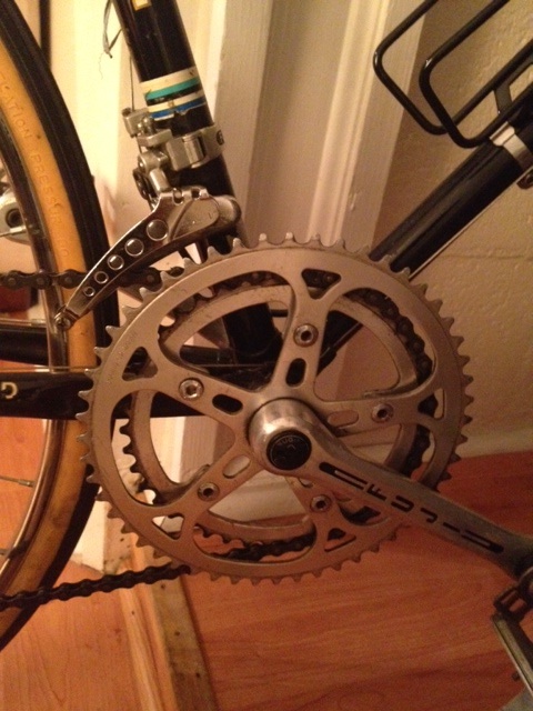

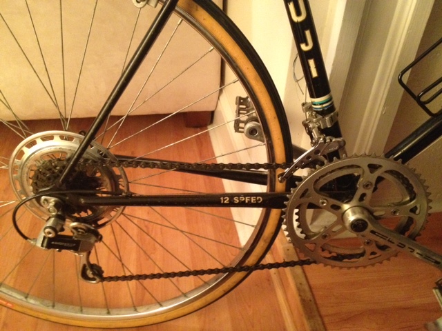

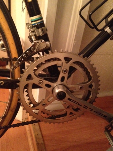

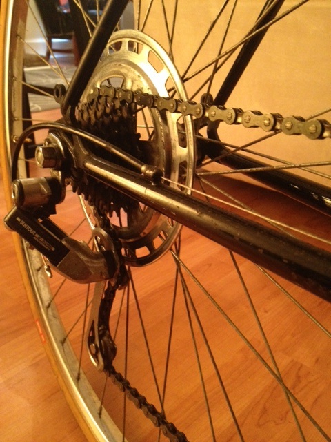

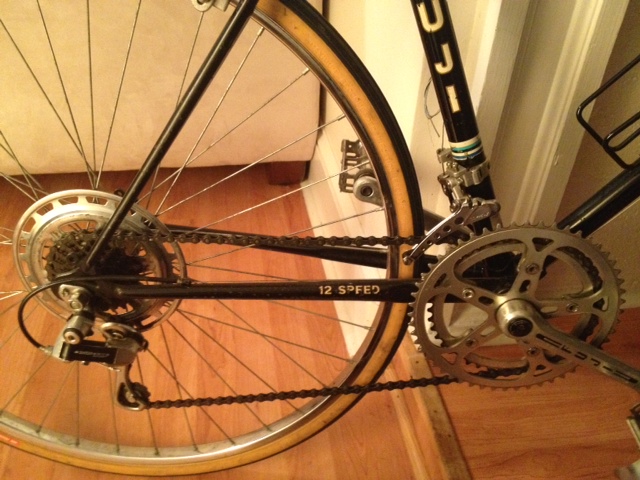

    I want to convert my 1980's Fuji Gran Tourer SE to a single speed simply because it is SOOO dang heavy, I almost roll backwards. I've been doing a lot of reading, but I'm still pretty clueless about the exact details. I know I want to put on lighter wheels (first!) before even doing the single speed conversion.
    That said, can you look at the pictures and tell me what measurements of crankarms, etc that I will need? I can't afford to have a LBS do this because I'm broke as broke gets.

    I doubt it'll get much lighter when converted to a single speed.
    This frame very likely uses the now obsolete rear dropout spacing of 126mm. You won't be able to find an off the shelf new wheel to fit this spacing. You'll need to have a shop narrow a modern 130mm spaced wheel, or space out a 120mm track width wheel. This bike likely also uses the obsolete 27 inch rim size. Todays 700c rims are a little smaller. This change may require brake calipers with a longer reach.
    You don't necessarily need to change the crank to go single speed. It is possible to take off one chainring. In fact, that is the most common way these days to procure a single speed crank for an old bike.

    Quote Originally Posted by Jordyne View Post
    Can you tell for sure that the spacing is 126 from the photo? I don't know anything about this!!!
    In the photo it looks like a six speed freewheel. That generally implies 126mm - except if it is a certain uncommon Suntour freewheel that squeezes six gears in place of the five on a 120mm spaced rear.

    If they don't you'd have to re-lace and re-dish the existing rear wheel and add spacers in place of the gear cluster to make them single-speed compatible.
    Barring that you could just get a Surly singleator and tension the chain and get rid of your shifters.
