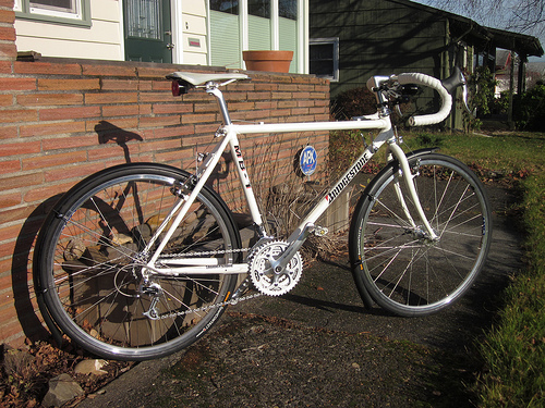

    My all rounder has 26 x 1.3" (32-559) and I run 35mm fenders. The attached picture shows the fender fit. I tend to run as narrow a fender as possible for the aesthetics. I will not run anything bigger than the 32mm tire on this bike.
