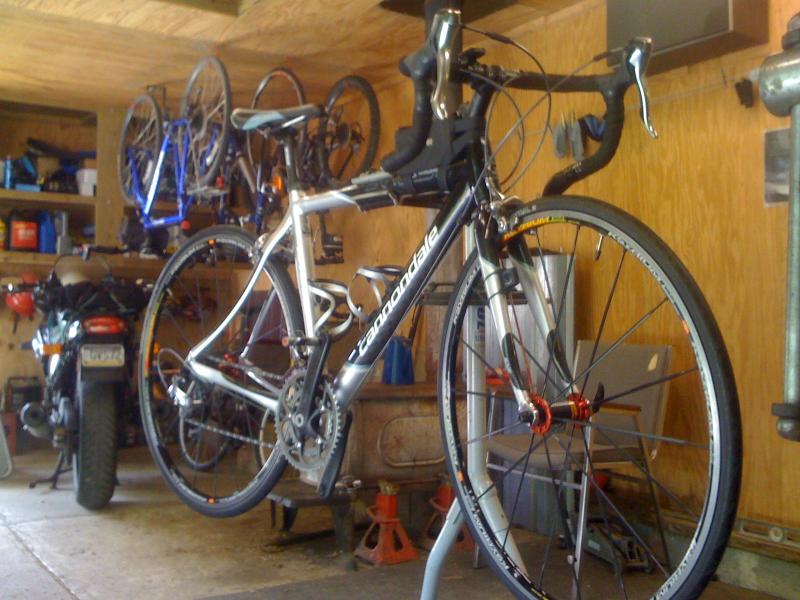

    I took my 2008 Cannondale Synapse Fem 1 to a local mechanic to get the shifter cables replaced and the bike came back with the shifter cables crossed underneath. Instead of the left cable running down the left side, he brought it around to the right side, then crossed it underneath, back to the left side. He did the opposite on the right side. When I asked him why, he said to prevent the rubbing you are talking about... I think you can see what he did in this picture. The crossed cables underneath bother my sense of order a little bit, but not nearly as much as the rubbing paint. And the only time I really see it is when I am cleaning my bike on the stand. It's hard to see in the picture, but the cables do not lay against the head tube anymore... there is a good 3/4" clearance.

    You have the older style shifters, where the cable exits out of the inner side of the shifter. Most of the new style (6700, 5700, etc) have the cables running underneath the bar tape for a cleaner look in front...which can make it harder for the cables to not hit the frame.
