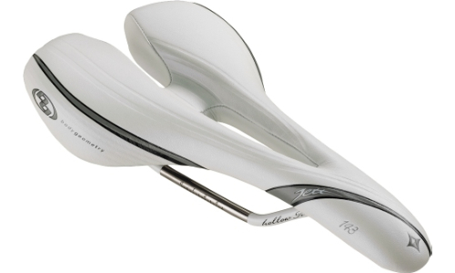

    Narrowing it down -
    Is the Selle Diva considered T-shaped or Wedge shaped?
    Also looking at Bontrager Affinity R and Specialized Jett.
    Pictures of all 3 attached:

    A wedge-shapped saddle is similar to a triangle. There's a very gradual transition from the wide part to the nose. The part between your legs is generally wider as a result.
    This is an example of saddle that I would consider wedge-shaped. Click the arrow to the right of the default photo to see a top-down view.
    http://www.fizik.it/product.aspx?c=VITESSE-HP-WOM
    A more t-shaped saddle has a more abrupt transition from wide part to nose.
    This is an example of more t-shaped saddle.
    http://www.amazon.com/Selle-San-Marc.../dp/B000O8BECQ
    We're recommending something more t-shaped because you basically want the part between your legs to be narrower.
