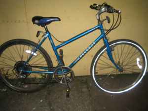

    Hi, just wondering if I can get some advice. I just purchased an 80's (maybe early 90s) peugeot for my sister. It's kinda a women's hybrid to best describe it I guess. So I'd love to remove all of the "noise" meaning the extra - the derailleur, the extra gears, the shifters, "the noise" as I like to refer to it. Anyway, anyone know how I can do this easily and cheaply? She'll be riding in relatively flat situations and the one gear should work and make the bike lighter and more manageable.

    Wow ever since I started riding a single gear, I just can't get enough - I love it! I've been riding it in SF for the last 2 years and now in socal. Anyway that said, I've decided to turn my sister's bike into a 5 gear I guess. I went to a bike store today for some ideas and he showed me a nicer single front ring (terminology??) and ten suggested leaving the rear cassette and that would clean up the look. And it's relatively cheap, $40 parts, $15 labor. So that'll work I think. Here's a before pic for you guys, (check out that world's ugliest seat!: o)
Name:	peugeot 15spd.jpg
    San Francisco
    141
    Hard to tell from the pic, but i also hate the funky stem. I'm hoping to switch out to an old nitto stem I've got.
