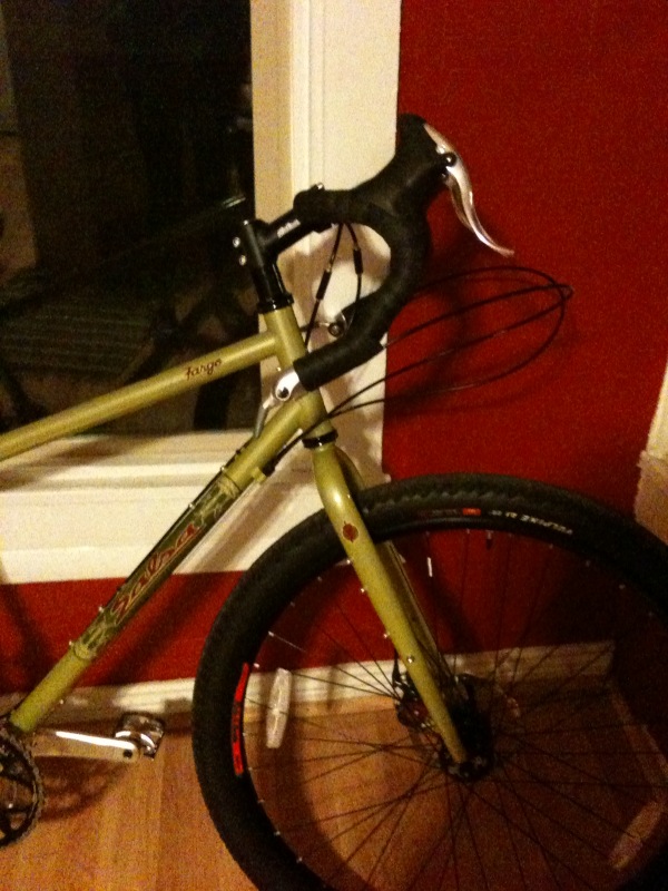

    Becky, here's a photo. I don't have anyone to take a photo of me riding (the cats aren't that skilled) and the light is terrible so the focus isn't so great b/c I took it with the phone. But it should give some idea:

    Bars are Salsa moto-ace bell lap.

    My gut reaction from the photo is that the bar angle is ok, but the the levers are too high on the bars..... Take that with a grain of salt...photos aren't as good as in-person eyeballing....
    What's the bar width? For me, too-wide bars can skew my reach, even if the rest of the bike fits well.
    I think that I would start by untaping the bars partway, moving the levers down a touch, and then retaping. I like to have a nice flat transition from the bar top to the lever's hood and that puts my wrists in a relaxed neutral position. See if that makes things any better...

    Looks to me like the bars are tilted up too much. Try making the bottom of the drops flat and see how that feels.
    I second this and Becky's suggestion of moving the brake levers. If neither helps your problems, consider getting some different handlebars as a different one may allow you to get things set up to where you need.

    I agree with Deb - it seems to be trendy these days to tilt the bars way up - I have no idea why.... but that is how shops put them together now.
    I prefer the bottom of the drops to be horizontal (otherwise I always feel like my hands are sliding down them) and the brake hoods to be level as well.

    3+ on moving the brake levers down or rotating the handlebars so that the hoods are flat across from the top of the handlebars rather than above the bars.
    Do you have a bike shop that you can bring the bike into that can do a fitting for you? They may be able to look and see if there are other problems in the fit that is making it difficult for you to reach the brakes.
