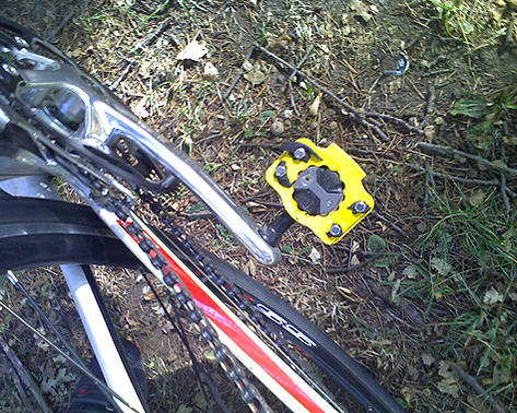

    I had my first accident on the road bike today. I won't bore you with details, but I was stupid. Anyhow, I'm fine, but my cleats didn't do so well.
    Basically, the cleat was ripped off my shoe and left on the pedal. Most of the spacer part remained attached to my shoe. I stopped at the bike shop and replaced the cleats on my way home. I mentioned to the guy that I hoped the shoes weren't damaged and he said they were okay aside from a small tear on the back part where the logo is, but they are showing wear (I've only had them since April). I've looked fairly closely and don't see anything that looks more like regular wear and tear.
    It's been suggested by a friend that given the situation, the integrity of the sole of my shoe might be compromised and I should replace them.
    Anybody else have experience with this kind of issue? I'd rather not have to replace the shoes because they were quite expensive and I got a really good deal on them.
    The shoes are Sidi Genius 5 Pro Carbon.
    The pedals are Speedplay Zero.

    Originally, that's what I was thinking. However, those aren't the screws that screw into the bottom of the shoe. The screws that attach the cleat to the shoe were still firmly in place. As you can see in the picture, some black plastic is attached around the screws. That's part of the Speedplay cleats that broke, which caused the cleat to come off the shoe. Parts of the cleat were still attached to the shoe.

    The only thing I can think of is that you stripped the threads. Since the cleat was screwed into a separate plate, then I'd think the only thing you could have stripped would be the threads in the screw holes on that plate. (BTW if you damage the ones in your shoes, they are likely replaceable). Unless you had some kind of impact to a non-replaceable part of the shoe (such as breaking a carbon sole), then the shoes should be fine.
    I'm the most concerned with why your cleat didn't release before being ripped off the plate. It's not that uncommon to break a composite cleat with the right kind of fall, but I've never seen Speedplays do what yours did.
