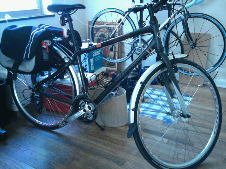

    Post pics! What model/year TranSend do you have? I have an 08 LX, the "men's" model, as I got a killer deal on it buying the prior years model. I love that bike, and commute several days a week on it carrying a fair amount of stuff. I ride it pretty hard, too, so I'm curious as to what you've done to it. So far, no issues. I've had it a year now and probably have at least 1,000 miles on it. The more I ride, the more particular I get as I've become more intune with my body. Definately want to change my saddle and handle bars (a bit too wide for me). Nothing major, just minor tweaks I'm more aware of now that I have another bike I'm more comfortable on.
    Got to say, love the disc brakes, and I find the shifters easy and responsive. Great bike i'll have for a long time, though I expect it to look a bit different in 10 years

    Jenn I am pretty sure my TranSend is a 2009. Here's some of the improvements.
