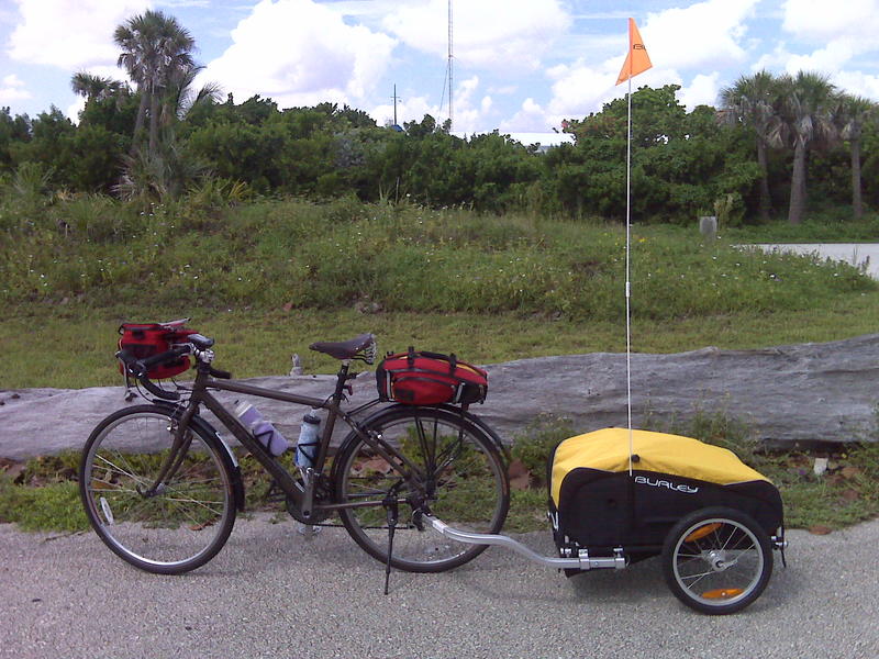

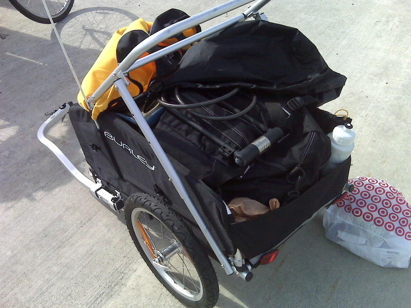

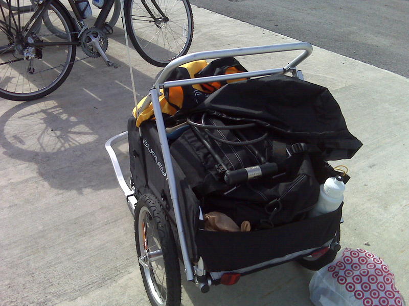

    Well, I have the Burley trailer and love it!
    Pros and cons of the Burley:
    Pos:
    1) It's tracks nicely. Very stable going down or up hill...no swaying
    2) The width allows for packing side by side, rather than stacking up.
    3) You can purchas a rack that will allow for extra gear
    5) It's cute
    6) Access is easy to gear is easy
    7) can carry up to 100 lbs easily
    8) Cars take notice of the width of the trailer and will usually steer away from you.
    9) Easily broken down to flat pieces, and tires removed for easy storage
    Cons:
    1) Width....when cycling down narrow side walks I have to make sure I have enough side clearance.
    2) The material is not waterproof, but can always be siliconed.
