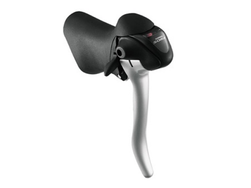

    Does your shifter look like this one? For the right shifter, to make the gears harder you click the little thumb shifter. To make them easier, then you push the whole lever into the center of the frame. For the left shifter, you click the thumb to make it easier and push and hold the lever toward the center to make it harder.
    Hope this helps.
