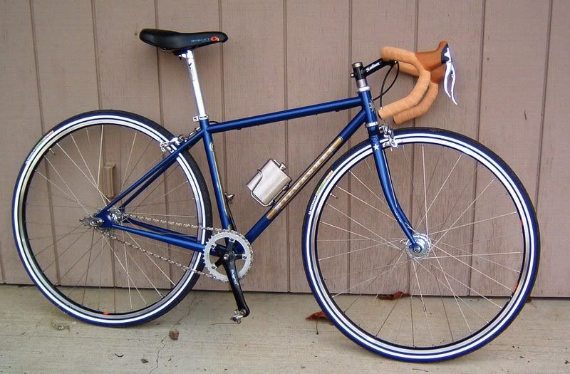

    Another option is to go with this aluminum 45cm frame from ChucksBikes.com. About $100 for an aluminum frame and fork. I also plan on getting a Sugino 160mm crankset to minimalize pedal strike. The thing that has me worried about this is that the dropouts are sort of vertical and I would have to run a chain tensioner or find a magical gear to get the chainline right. Also I'm worried about how full aluminum would ride. Would it be too harsh for just riding around on the streets?

    Another member on bikeforums.net built up the aluminum frameset I was talking about for his girlfriend. This is how the bike turned out:
