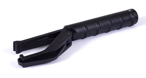

    I use a Tire Jack.
    http://www.hostelshoppe.com/cgi-bin/...ory=1169247237
    The only negative thing about it is that it's sometimes too long to put in my seat bag. Otherwise, it works miracles!

    I use a Tire Jack.
    I use one of these too. It's great. It's lightweight and fits in my handlebar bag.

    How long is the tire jack ? I am glad to hear that I am not the only one who wrestles with tires. I think it was sooo hard to do cause they were Specialized Armadillo tires and brand new too. I bought some Pedros tire levers which are a lot stiffer than the ones I had, I have not tried them yet. I am still waiting for the feeling to come back to the ends of my fingers
