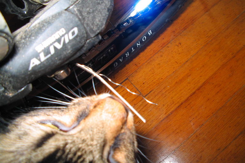

    A question: My cats have chewed off the little caps on the cable ends. Because of this, on the rear derailleur, one wire in the cable has unwound itself from the others. (Note how the little one, Erin, is helpfully pointing out the problem for the photo.) If it's a cable issue, is it possible that this could be the source of the problem?

    Well that is definitely not good for the cable. It may not be catastrophic though.
    Does the skipping (since the bike isn't trying to jump into other cogs, what you described is called "skipping") happen more on certain cogs? If so, which ones? Does it make a difference if you have shifted down into the problem cog or up?
    I don't know why the LBS messed with your front derailleur. That seems to have just gotten your shifting even more screwed up.
    Try loosening the FD cable (turn the barrel adjuster on the frame clockwise) and see if that lets you shift into the small ring. You may need to really loosen it. Then, once you're in the small ring, see if the chain is rubbing the cage. If so, then it could also be they set your lower limit wrong. Loosen that limit screw (the one closest to the frame) until there's no more rubbing. If you get rubbing now in the large chainring, then you probably loosened the cable too much. Shift to middle ring, tighten cable, then check up and down shifts again.
    As for the back, what other information can you give? In addition to my first questions, is it slow (a hesitation) to shift in either direction (inward or outward)?

    Quote Originally Posted by aicabsolut View Post
    Now that I've looked at that Sheldon Brown info, I can say that I have experienced both skipping and autoshifting. What happened this afternoon was skipping.
    It only seems to happen when I'm in the smallest chainring, am in the 3rd or 4th cog, and am grinding up a hill. The skip or autoshift will occur well after my last gear change.
    He fixed it today. Front derailleur is fine now.
    Had a lot of chain rub after he messed with the front derailleur, but it was fine after he readjusted it today.
    Shifting is nice and crisp. The problem only occurs under load, as when I'm going up a hill. It doesn't happen during or right after a shift. It happens well after the last shift, making it totally unexpected when it does occur!
