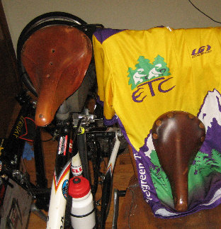

    I think a year or two ago here, that MimiTabby's husband ruined her Brooks saddle by riding it for many miles in the sopping rain, and it wound up being permanently formed exactly to his butt crack! As I recall, Brooks was not able to attempt to fix it, so it was basically trashed. I think she posted photos of it that were too funny funny....Mimi, can you repost those here by any chance? It was not to be believed.

    Hi, he didn't ruin MY Brooks saddle, he ruined HIS B17 Brooks saddle.
    And he rode in heavy rain for many hours. I'm thinking a thunderstorm or two

    here's the warped from rain saddle on the bottom
    That must have been some wedgie
