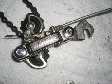

    The good news is I just purchased a new mixte. Pictures are forthcoming, but the bad news is that first I have to figure out how to get her back together (bought over e-bay and shipped in parts). I'm all done except I'm stuck on the rear derailleur. There is a hole that's not matching up where it should (based on the marks on the paint from before it was taken apart)... Does anyone have a close up picture of a Shimano Lark SS (or any Shimano Lark or Skylark series rd - they are all pretty similar) that they could post? I'm desperate here - one weenie little derailleur is standing between me and my first ride on a mixte!

    1. Rear Derailleur

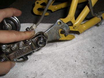

    2. Dropouts

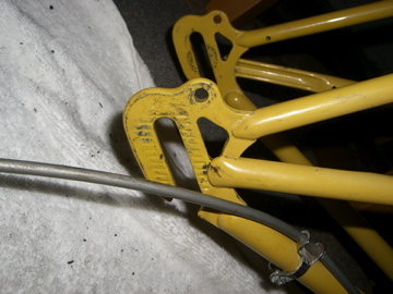

    3. How I thought it went together

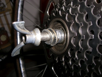

    4. Wheel

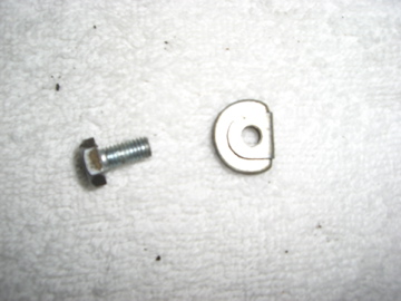

    5. Bolt and nut for assembly

    The bolt and nut go through the derailleur, but not through the screw hole in the frame. That shaped piece that the bolt screws into fits into the dropout itself, the same slot that your rear wheel axle fits into. It fills the space in the rear of the dropout slot, and your axle fits up against that. See how the shape of that piece is recessed to fit the dropout on 3 sides, and the axle on the 4th side? This is the way all rear derailleurs were mounted before derailleur hangers were built into the frame.
    Massachusetts
    2,556
    The hole in the frame above the dropout is for mounting a rack or fenders. The big slot in the derailleur's mounting plate will end up matching the frame's dropout and your rear axle will go through both. Derailleur should end up hanging almost straight downward. When you insert the rear wheel, the right side of the axle will butt up against the derailleur mounting plate, and the left side will be in the middle of the dropout. You just hold the wheel so it's centered (check the rim at the chainstays) and tighten the axle. Sometimes a pain to center the wheel because there is nothing to hold the left side in position.
