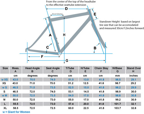

    I realize that I need to be "fitted" for a new bike, but my current bike is literally on it's last leg and I need a new one fast. I am looking to get the Giant OCR A1 women's specific. I have been calling shops in my area (to see if they have any in stock) that are Giant dealers but I'm not sure of my size since the women's compact sizing differs from the men's. Someone told me I was a 50cm because I am just under 5'4". That would make me a size medium on the women's giant. If that's the case, that seems awfully weird that Giant would only make this specific model of bike for women 5'4" and under (they only list XS, S, and M as size options). What am I doing wrong here? haha

    Found this on Giant's website:
    (Here's the link: http://www.giant-bicycles.com/en-US/...en/1246/29289/).
    Assuming this is the correct chart, based on my (non-expert) assessment of the top tube lengths, I would think that at 5'4" you would be choosing between a W-XS and a W-S (or a regular XS and a regular S). It looks like the bikes have a very big slope to the top-tube, so the seat-tube length (=nominal frame size) that "fits" you is going to be shorter than with a less compact frame.
    A 54 cm top tube (which is what the W-M/50 cm frame has) seems biggish for someone your height, at least in the abstract. If you were looking at a bike with traditional geometry, on the other hand, a 50cm bike would likely have a 51/52 cm top tube (approximately), in the same range as the XS & S compact Giant frames...
    Others who have experience with Giants may have more to offer though...
    good luck!

    I recommend you take your measurements with the fit calculator at http://www.competitivecyclist.com/za...LCULATOR_INTRO
    For me, the numbers it gave me for the "Eddy Fit" are exactly what I went with on my bike. It worked great. Since the bike you are looking at has a compact geometry, pay attention to the top tube measurement particularly. That's column D in the chart above. Just measure yourself carefully, and that should get you the right frame size.

    Also... You need a standover height that is equal to or less than your inseam in bare feet. That way, when you are in shoes and cleats you will have at least an inch of clearance. I am 5'6" and have a 29 inch inseam measurement. So.... very short legs. Because of that, these Giant bikes would simply not work for me. I need about 52.5 cm top tube but a standover of 29 in or less. You can see that there are no bikes on the chart that have those measurements. My bike has a 52.5cm top tube and a 28in standover. Perfect fit.
    That's another good reason to do the fit calculator. Get your optimum top tube range and inseam measurement. Check bike geometry against those two numbers.
