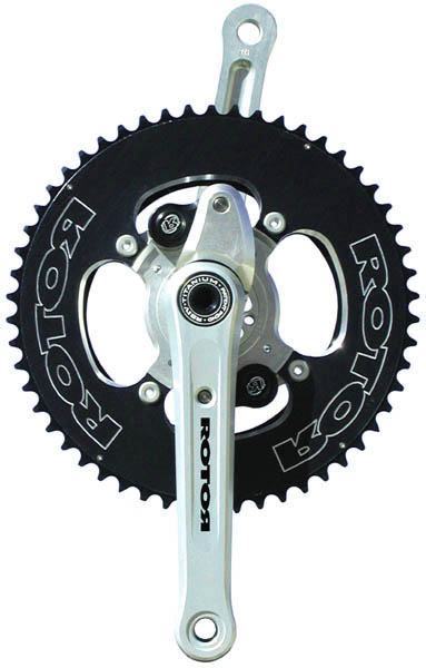

    Here tis...

    The RotorCranks can be adjusted depending on whether you are using them on the flat or over hilly courses. I would see myself using them on the flat - in time-trials. So they would go on myt dedicated time trial bike. I have a relatively slow cadence, so if I am doing a cadence of 70, thats 140 times EVERY minute I have to push through the "dead spot" at the top of the pedals using "normal" cranks.
    Theoretically, if you eliminate the extra energy needed to get through that zone, you have a smoother more powerful stroke - and therefore are faster for little extra effort.
    RotorCranks would probably suit me more than someone with a high cadence.
    However, at nearly US$1000 for the ones in the above pic, I need to be sure of this experiment.
    If I do try them, and I like them, I would also consider getting a second set (time to win the lottery!) for my road race bike, as I still struggle on hills and (again theoretically) RotorCranks shouls enable you to push a higher gear up a hill, which means you get to the top faster...

    I know of a gadget geek who tried it. This was when they first came out about 2, 3, 4?? years ago. I was Anyway, one of the bolts kept on working its way loose and the loose bolt managed to bang into the chain stay. It damaged the frame. He returned the cranks and got his money back. I don't know what became of the damaged carbon frame.
    I'm just an old purist of sort. Hated the elliptical ring thingy back in the early 80's. Those made your pedal stroke worse not better and turned you into more of a pedal masher. And the cranks you are talking about adds all that extra weight and what do you get in return. Get rid of your deadpot?? pretty small thing for the very small added power and at what cost?
    I think its best saved for those with lotsa money to burn and not much ability.
    --------------more info -------------------
    Did talk to the gadget geek. He said the cranks weighed a lot and he didn't think it was worth the weight. As for the damaged frame, it was a Kline not Calfi frame. He said his Kline frame was totaled because of it. He just got his money back for the cranks but nothing for his frame.
