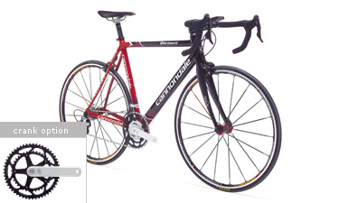

LBTC and I were at the LBS looking at carbon bikes and I mentioned that my next bike is going to be a really good one. Later, she was at another bike shop and found a 2007 Cannondale SystemSix Team Si Replica that she thought I might like. It sounds like wayyyy too good a bike for me, but because it's on sale so cheap, it's in my price range (and size)! I have looked online at pics so far, haven't been down to see it / try it yet. Anyone know much about it and can give me some feedback?
And will everyone in town laugh when I am still a hill slug on such an awesome bike?
Here's the info and pic from their website.
Frame SystemSix Team Si
Fork SystemSix Carbon
Rear Shock N/A
Rims Mavic Ksyrium ES
Hubs Mavic Ksyrium ES
Spokes Mavic Ksyrium ES
Tires Maxxis Xenith Hors Categorie foldable, 700 x 23c
Pedals N/A
Crank Cannondale Hollowgram Si w/ SRM, 39/53, OPTIONAL
Cannondale Hollowgram Si, 39/53
Chain Campagnolo Record C10 Ultra
Rear Cogs Campagnolo Record, 12-25
Bottom Bracket Cannondale Hollowgram Si
Front Derailleur Campagnolo Record QS
Rear Derailleur Campagnolo Record
Shifters Campagnolo Record QS Ergopower
Handlebars FSA K-Force Carbon
Stem SystemSix C1 Carbon
Headset SystemSix C1 Carbon
Brakeset Campagnolo Record Skeleton
Brakelevers Campagnolo Record Ergopower
Saddle Fi'zi:k Arione Ti, Team Edition
Seat Post USE Alien Cyclops Carbon
Colors Barloworld Team Replica (gloss) (BWD).
Sizes 48, 50, 52, 54, 56, 58, 60, 63 cm

The only thing I would wonder about is the 53/39 and 12-25. If your racing involves a lot of climbing, those are some serious gears.

Yeah, I was wondering about that too. I have a triple on my current bike and we do a LOT of climbing in my regular riding, but the TT route and the routes on the races I'm considering are mostly rolling hills. I think I'm ready to go to a compact double but I don't know if I can get that on the systemsix. I wish I had time to go down and find out more but I'm busy after school every day this week. Maybe Thursday...
Most (if not all) shops will swap components for you before you buy the bike. Campy makes a compact (centaur 10 speed) and a record series triple. I personally love my compact double (less choices is easier) but will go triple for a big ride next summer (16,000 ft of climbing). You should call the shop and see what kind of offer they'd make for swapping parts out.

So see if your LBS can swap the 39/53 to 34/50 but other than that,
the SystemSix you’ve shown on here will be a seriously sweet ride.

Starting in 2007, Campy separated their triple crankset collection from their doubles. The new triple series are called Race, Comp and Champ. Other than, that, I don't know too much about them because I don't know anyone who uses them. I doubt you can get a 165 or 167.5 Campy crank with them, if you need it.
For your doubles, only Record and Chorus allows for multiple "Quick Shift" technology. If you're racing on rollers, the QS will be your friend! Centaur and lower only allows 1-2 shifts at a time. Both Record and Chorus are available as compacts (you will also have to go from a short to a medium FD)
I run a 50-34 compact double but it's not all Campy. I needed easier climbing gears so I got a 12-27 cassette made by Miche (Campy doesn't make a 12-27, but they do make a 13-29) and 165 S-Works cranks. They're great for all the hill climbing I do and good enough for a sprint, too.
