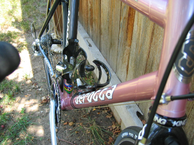

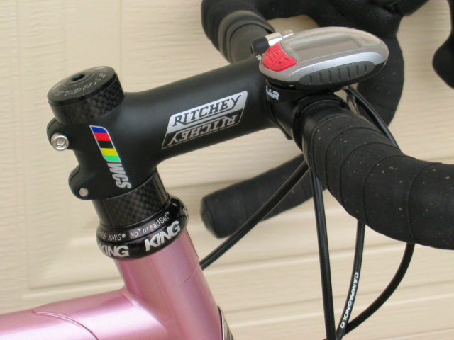

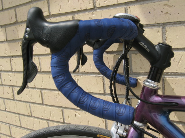

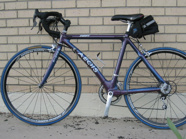

    Heres pics of my two bikes the first is the Aegis. It's a long story but here's how it ended up for my short arms. The HT length is 8.4 cm.
    The second is my custom bike. It does have spacers and is designed for me to go higher or lower depending on what is comfortable for me.
    Compare the differences between the ht's. I think the Serotta Ht is something like 14 cm. The Serotta has a 1 degree slope but it doesn't look like it.
    Also consider your shoulder width. Orginally I had a 38 cm handlebar on my Aegis. When I was fitted for my Serotta I found out I needed a 34 cm handlebar! Only one company makes handlebars that small but having the correct fitting handlebars helped too.
    Trek Pilot's have a longer ht but wasn't long enough for me.
