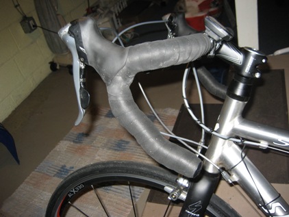

    Mine are the Bontrager FIT, as well (purchased from bike4ever, actually...thanks, again!). And I did have to switch to an oversize stem for it, but I wanted a slightly shorter stem anyway, so it was no big deal for me to do that.
    The Kalloy Shortreach is similar, but doesn't need an oversized stem. And everywhere I've seen them online puts them in the low $20s range in price. (Here's one example: http://www.jensonusa.com/store/produ...h+Roadbar.aspx) That's what I was going to try out when I decided I wanted to try a shorter reach bar, because the price was low enough that I figured it woldn't be a huge loss if I didn't like it...and then I found a great price on the Bontrager bar here on the forum.

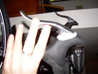

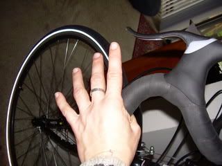

    A bit of thread drift here, but related...let me know if this question had been done to death on TE...
    I have very tiny hands, and the reach to the brakes is always a challenge. I'm currently double-shimmed, and it compromises excellent braking.
    Do short/shallow bars help with actual finger reach to the levers, or does the short/shallow aspect only help with arm reach to the drops/bars?
    I LOVE riding in the drops and use them often. My issue is really with the small size of my hands for the brakes (and I'm trying to avoid getting short reach levers on a bike I might not keep too long).
    I have little hands and really short stubby fingers. I switched my bars and my levers at the same time, so I don't have real evidence, but my instincts say that the bar on its own wouldn't have done much to improve my finger-reach to my levers. Even though the total reach is shorter, your hands and fingers are still the same distance from where they rest on the bar to where the levers are. (At least, that seems logical in my head.)
    I found my Shimano shortreach levers on eBay. When I had them switched out, I kept the ones that my bike came with so that when I decide to get a new bike, I could just put the old ones back on this bike and take the short ones over to the new bike.
    The change was great, though. Shifting is a breze, and I feel way more secure now...and going downhill no longer scares me, because I can confidently reach and handle my brakes.

    Changing to a short reach bar does not shorten your hand reach to the brake levers. You'd need to get short reach brake levers or shims for that.
