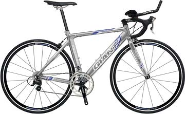

    Giant TCR Aero 2
    This is my current race bike which I use in TTs.
    I am 5'10" and have the small frame. I have long legs and a shorter back, I am told.
    I will be getting a road race bike at some point, just for road racing (maybe an EMC) - but I want to keep this Giant and make it TT specific... put bar end shifters on the aero bars - not gonna change the actual aeros at all because the whole set up is so comfortable to me.
    I suggest you get hold of one of these to try out in an xtra-small, or the most current model (the Aero 2 is a 2004 or 2005 model). It cost us $NZ1200 new, so well within your price range. I do not want a different bike to TT on, though I will be looking at a disc wheel once my TT times improve a little more.
