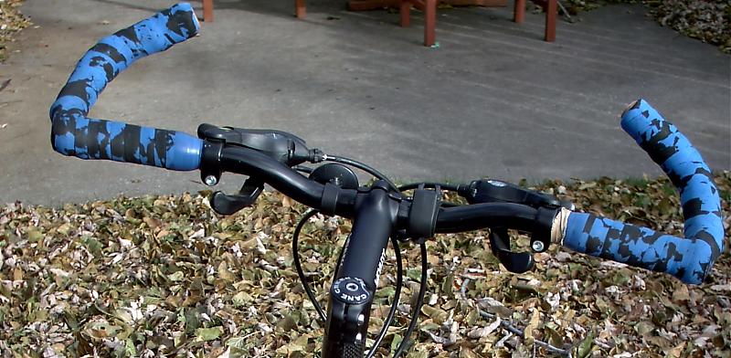

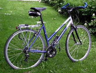

    I had my hybrid set up quite comfy with bar ends. First, though, I cut the bars narrower, put on ends and then opted for bar tape ... which made a nice uniform holding surface with lots of choices. Finally I realized I just prefer my hands parallel to the bike and went with drops. I also couldn't get my risers quite narrow enough for my comfort.
ID:	1653   Click image for larger version.
