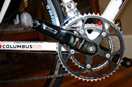

    new crankset on my Epesi
    My sweet Epesi (Specialized Allez Comp 18) returned from CA with her new crankset.
    She had the stock Ultegra 53/39 front with a 9sp 12-27 cassette. I didn't want to go triple, but I wanted a lower "granny" gear for the hills.
    Chris at Robinson Wheelworks (can't remember the town... Dita?) made some great suggestions based on my current and goal riding style plus keeping it USCF legal so I can race if I choose to.
    We ended up agreeing on the following:
    - kept my existing Ultegra cassette
    - installed an FSA compact 50/34 with compact compatible derailler
    I lose 1 top end gear, but gained 2 low end gears.
    And here's a picture...
Name:	FSA crankset.JPG
    no regrets!

    Anyway I like this setup because I can work the "spinning" on hills, getting my cadense skill work done without jeapardizing my knee and I still have the future option of choosing a new cassette setup as I get stronger/faster.

    Report on my new FSA crankset
    This is an exerpt from the note I sent Chris (the mechanic) in CA.
    Preface it with the fact that on my old crankset, I stood on every incline on this route for at least 1/2.
    "I took the bike for a quick 10 miles around my neighborhood... did 4 laps of a 1.5 mile course. It has a couple of 200 meter flats, 2 x 2-300 meter climbs (est. 8%) then, as I get toward my house 3 very short (25 meters) but increasing incline 10%-18% with double S-turn.
    I was able to stay seated and spin the entire route except for the last bump up in incline on the last hill. But for 25 meters, I'll stand.
    Additionally, on the downhill (gradual) between the 2 longer climbs I was able to spin with a bit of resistance (85-90 rpms) to hit 26 mph and then hold it just at 20 mph in a lower spinning gear going uphill."
    Needless to say grrls, I'm liking the new setup. Now if the weather would only hold.
