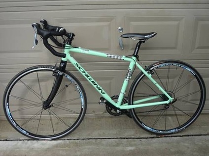

    The issue is partly the fault of the manufacturers who are stocking such ridiculously short stems on WSD bikes. We get it all the time people who want to go UP a frame size to get a longer reach. This is such a huge mistake and bikes end up looking like the attached pic. A bike set up like this will NEVER be able to achieve a normal upright riding position. Much better to put a normal stem length onto the proper fitting frame.
    Secondly customers need to be willing to change STOCK parts on production bikes rather than getting "freaked out" that it doesn't fit straight off the shelf.
    The other issue is the plethora of incompetent people who call themselves "fitters"

    Please don't take offense IBFP. Wasn't intending to make any comment about any one person in particular. I chose your quote because I found it very shocking to hear a fitter say that someone who is 5'0" could fit on a bike made for someone who is at minimum 4 inches taller than you.
