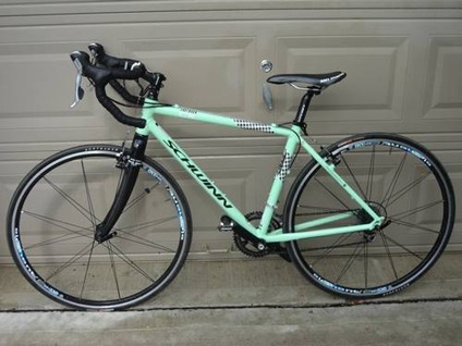

    The issue is partly the fault of the manufacturers who are stocking such ridiculously short stems on WSD bikes. We get it all the time people who want to go UP a frame size to get a longer reach. This is such a huge mistake and bikes end up looking like the attached pic. A bike set up like this will NEVER be able to achieve a normal upright riding position. Much better to put a normal stem length onto the proper fitting frame.
    Secondly customers need to be willing to change STOCK parts on production bikes rather than getting "freaked out" that it doesn't fit straight off the shelf.
    The other issue is the plethora of incompetent people who call themselves "fitters"

    Quote Originally Posted by Seajay View Post
    I'm not sure if the part I bolded was directed at me, but I have changed out the stems and the handlebars on two of my bikes already this summer. And I don't "freak out". As a matter of fact, I really dislike that term and usually roll my eyes when I hear/read it.
