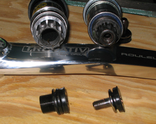

    I bought a crank puller and got the cranks off only to discover that the replacement cranks don't fit. Apparently there's more than one size Isis link?!?

    There is ISIS with 10 splines and Octalink with 8 splines.

    Yeah, I know. Both my old cranks and new cranks have 10 splines (I've counted them repeatedly, disbelieving), but the new cranks seem designed for a larger diameter linkage; they fit around the BB splines rather than properly fitting an engaging with them. The old and new cranks use a different crank bolts, too. Would you like to see some pictures?

    Two Isis Drives!
    I ended up buying a new bottom bracket so that I could use the new cranks. If you're interested, here's a picture of the two Isis drives; the new is on the left.

    even though you have bought a crank puller, it still is cheaper to DIY and you learn more about your own equipment.
    And I learned something too
    Thank you for posting the picture.
