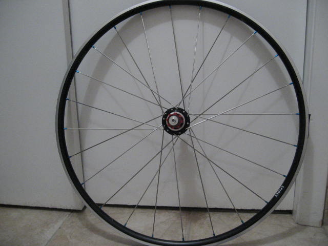

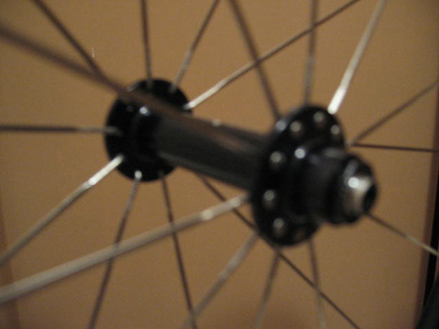

    Jeremy is well known by the guys on the Serotta forum. He often posts there. My wheelset weighs 1185 grms., less the skewers, the rear hub is made by Tune and the front hub is American Classic. Jeremy rebuilt the AC hub to his specifications. We went with the AC on front because of its light weight.
    My spokes are Sapim's, 20 f, 24 r. I rode the bike in 30 mph crosswinds in N. Dakota and got some pull but nothing like I got when I had Mavic Open Pros.
    The wheelset was about $800 with shipping but the cost was well worth it for the comfortable ride I get. When we rode Cycle North Carolina this fall we had some nasty chip n seal surfaces. Most riders slowed down but I didn't need to slow my pace at all. I've ridden lots of Indiana roads and this surface was as bad or worse.
    I've got almost 2,000 miles on my bike and no issues so far with the wheels.
    Here's pics.
