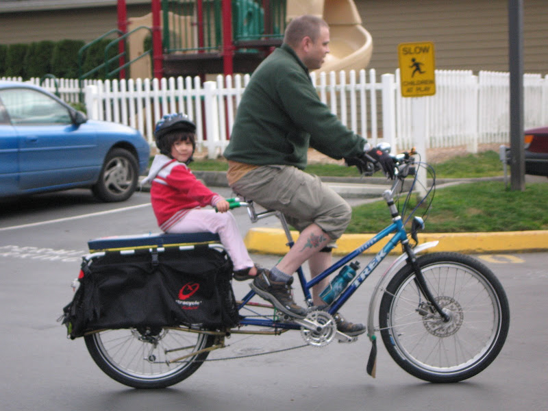

tjf9, my Dh borrowed an Xtracycle this past spring from one of his buddies that used a step-through mountain bike frame with 24" wheels (I think, or maybe they were 20"). At 5'8" he could ride it pretty comfortably and the frame was small enough that I could probably ride it too with the seat lowered and the handle bars angled toward the seat a bit. BTW I'm 5'2" with a ~27" inseam and I could straddle the top tube comfortably. Here's a pic for you:

Cute! Looking at the pic, it looks like the "stoker" handlebar is attached to the seatpost of the, oh, whatever the front person an a tandem is called's seat. We were thinking of putting a handlebar on for the kids, so that may impact our bike choice a bit - or at least impact how we attach that rear handlebar. A picture is worth a thousand words. Thanks for sharing that!
Thanks, that DD.And ,yes, the handlebar is attached to the seat post. It works with Dh because there's a lot of seat post sticking out that we could find a position that worked for DD and DS (who's about a foot taller). However, due to my short legs, I need the seat post almost all the way down which means there isn't much of the seat post with which to work. It brings the handlebars too low for either child to comfortably hold on for any length of time. IMO with the differences in heights of the riders, I'd find a way to attach the handlebars to the Free Radical itself. I've seen it done. I'm just not sure if it's sold in a kit or a DIY project. I'd talk to the guys at the commuter bike store. They probably have a few ideas on how to go about it.

Looks like there was enough seatpost left when both DH and I rode it to attach the stoker handlebars to the captain's (aha!) seatpost. The folks at this shop have installed that enough times, they thought it would be no problem.
