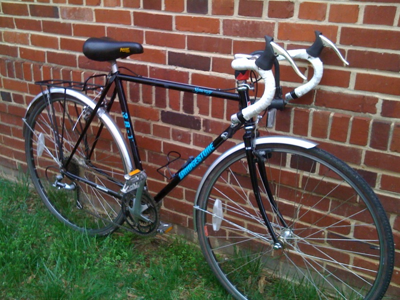

    As promised, I'm posting a photo of the beaut. Thanks again for your advice and opinions.
ID:	9013   Click image for larger version.

    Vena cava -- congrats on a beautiful bike! Wow -- it's really pretty. Many happy miles .
    You may want to tweak the bar/hood position a bit -- that looks like a hard position to brake from, esp in the drops!

    Thanks! That's a comfortable bar position for me, perhaps because my default hand position is right on the hoods.
    Beautiful bike!!! I'm glad it's going to work out for you, because it would be a shame for you to have to give it up after finding such a great bike.
