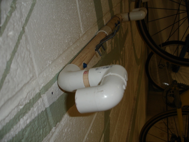

    for the bike rack i didnt do any measurements or anything, just started with old sprinkler parts and started piecing it together, holding the bike against the wall and figuring out rough dimensions. then i dry-fit it together, did some more cutting or replacing pieces that were cut down too much, then when i was happy i glued it all together. i used 3/4" PVC, 90-degree elbows and masonry screws (blue tapcons). oh and old pegboard hangers for the helmets.

    tiger, the helmet is a trek anthem. i added the reflective strips. i broke the restraining strap and emailed trek and they replied and gave me the part number to order a replacement, i thought that was very cool. i also have a giro atmos, but the anthem is so much better for the ponytail!!
    diva, i cant picture what you're referring to. the couplings? theyre not necessary, i just had pieces of PVC laying around that already had elbows glued in, so i used those and then had to use the couplings to make it the right length. i wouldve preferred not to use the couplings but i am (a) cheap and (b) lazy. the elbows are 31 cents at home depot.
    aggie, find a stud. on the wall, on the wall! sheeesh. i dont think anchors will be strong enough.
