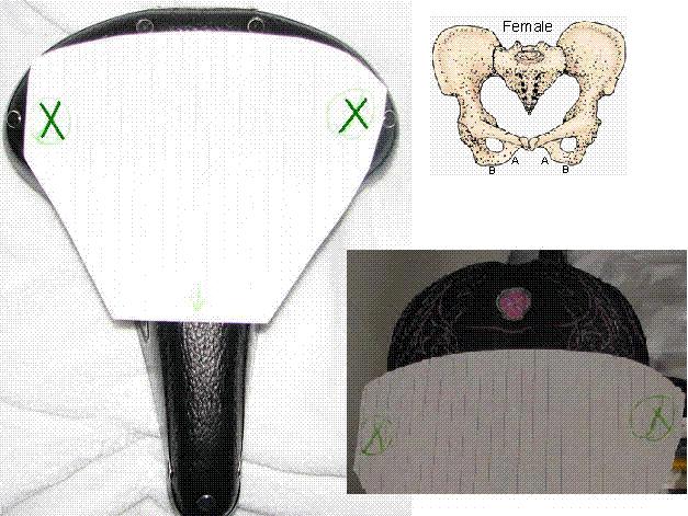

It took a while to figure out how to share the detail - it is absolutely the B68.
Process: I set a piece of paper on my office chair, sat for a good long while & built up sit bone impressions. X marks the spot - also circled where the sit bone area left a nice round indent.
The first picture should show the overlay when I compare that to the brooks, and to my other too-narrow saddle, where I'm supported by the A bones, not B.
On the brooks, the center of the sit bones are one fingernail width in from the furthest outside rivet. Is this enough? I tried to draw lines to intersect where the center of the sit bone would hit in the smaller brooks image. Moving front to back on that saddle would e limited to the green line which I measure out to 2" in total -but most of it is hard from the curl of the leather or the pomel underneith.
I know you're not going to like this; but that's about where my sit bones are too.
That's not far off from mine either. On my B17 my sit bones were even closer to the edges- that's why I got the B68. Even so, the B17 was comfortable after the first couple of weeks of heavy riding.
Now on my B68 my sit bones are like where yours are. I think yours will be ok after the saddle -and your behind- are both "broken in".![]()
Have you proof-hide-ed the saddle much yet? That really helps it soften and form to you. Proof hide several times, on both sides (top and underneath).
Yup, that's about where mine are, too. Welcome to the Wide Sit Bone Club! You'll not find many saddles this wide, but yer body will thank you for sittin' on the sit bones rather than on the inferior (that just means "lower") pubic rami.
