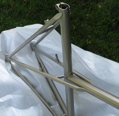

    I am planning to commission a small production run of USA hand-made mixtes, here is a picture of one that is built up and another that is about to be built up.
    I am most interested in comments, please see my blog and google group for my information.
    Thanks,
    Michael
    http://furrybluecycles.blogspot.com/
    http://groups.google.com/group/furrybluecycles

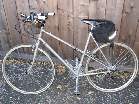

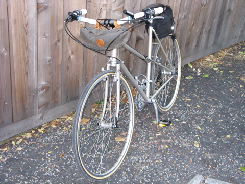

    My new mixte, went for my first ride this past weekend.
ID:	6322   Click image for larger version.

    Quote Originally Posted by furryblue View Post
    Thanks,
    Michael
    Hi Michael, I must confess part of the delight a lot of us have in our Mixtes is that since they are predominantly women's bikes, bike collectors (who are predominantly men) tend to ignore them. Thus, they are an excellent value and are not appreciating in value at near the rate of equivalent "men's" bikes.
    I am enjoying your blog, however, and am glad that someone is building a few mixte's.

    Hi Claudia (uforgot),
    Here's in brief the story of my mixte. I have problems from time to time with wrist pain, so the mixte story starts with my search for the perfect handlebars.
    I put the Albatross bars on my road bike and overall liked them, but the position was a bit too upright for me without switching stems and so I started thinking about a custom frame that might have a slightly longer top tube so I wouldn't need a really long stem.
    Also somewhat relatedly, because of the position I like (semi-upright), and my proportions/height, I am kind of on the border for a properly designed 700C frame for drop bars - I like to be positioned a bit behind the pedals and with my desired reach to the bars a "normal" road bike will have more toe overlap than I like. Having a custom frame with a slightly longer top tube for the swept bars yet enough standover clearance for me seemed like the way to go.
    Another idea I had was to explore commissioning a small run of hand made "versatile road bikes" (not a hybrid, not a touring bike, but able to take on medium width tires say 25 - 35 mm) because I felt the bike makers weren't making what I wanted. When I met with my favorite local bikeshop, the owner said he would like to see someone make a nice road mixte.
    So, the idea of a bike designed for swept back bars and with a little extra standover clearance got merged with the local bikeshop's idea for a mixte.
    With perhaps a few exceptions that differ from my mixte in various details,the mixte has disappeared as a model from current bikes and I thought it would be fun to bring it back in a "new/old" version.
    Hope that makes sense.
    Cheers,
    Michael
    Hi Mimi,
    I hadn't thought of that, so you're saying part of the appeal/interest in a mixte is the "I scored a good deal" aspect. Thanks, that is a very interesting comment!!
    As I attempted to explain in a previous post, my personal interest in a mixte started out as just wanting a little more standover clearance and less toe overlap with medium width 700C tires, and certainly a "compact" or "semi-compact" frame design could work. Growing up, I had a fairly macho uncle who rode a mixte, and I like the sort of retro-look and didn't think of it as a "women's bike" and thought it looks more elegant than a bike with a really long seatpost.
    Cheers,
    Michael
