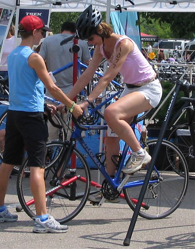

    I'd like to get a bike for the GF as an Xmas present. She's 6'1" and about 145lbs. normal women build.
    She is a Trek fan and currently owns a 1985 Trek touring bike which has a top tube length of 23 inches(58.5cm) and a 25 inch(63cm) 'vertical' seat frame tube length. I have no clue what 'size' it's classified as.

    At a triathlon event, she demo'ed a '06 Trek 5000 WSD in a 57cm frame this summer and came back from the test drive beeming about the bike. I asked how the fit was and if she felt cramped or uncomfy but she said 'No, it was awesome!'. In theory, a 57" is way too small for a women of her height and I'm guessing she may have been so excite about the bike that she didn't feel the fit properly.
    I've talked to my LBS and they recommend a mens '06 Trek 2200 in 58 or 60inch for a nice price of $1400 (but only at that price till the end of the week, then it jumps back up to $1700 or so) and they shyed me away from the '07 5000WSD for $1700 thinking the fit would be really poor and too small for her.
    The 2200 is obviously the better deal and has better components but lesser of a frame and is a mens frame.
    The 5000 is nice carbon and made for a women but is it too small for my gf ?
    Below is a pic of her being fitted 'as best as possible' on the demo 57cm bike.
    What do you all think? 5000 in that pic an ok fit for her? Or stick with the 2200 instead and in what cm size?

    Geez...you know we can't answer this for you.
    I would think that you really need her inseam measurement.
    My first thought...and I'm a COMPLETE amateur...is that the 57cm is too small for her.
    Is there any way that the bike shop could swap out the bike after she receives it in order to get the best fit?
    I don't ride a WSD...I ride a regular Trek a 58cm. I'm 5'8" with a 34.5 inch inseam. Most people of my height do not ride a bike this big.
    Have you considered the 5000 (not WSD)?
    I personally would go with the carbon frame. And if this is an 07 bike it would be more likely that the bike shop would swap it out after fitting her.
    just some thoughts

    test drive that puppy!
    best way to choose the best sized frame is to actually get her on it to test drive that puppy!
    If she reckons the WSD suits her I would not discount her opinion of it so quickly!
    Theory doesn't account for much! I'm supposed to be a small yet I was much less cramped on a M frame than a small.
    In her opinion of the ride it may have been the overall ride of 07 WSD that she loved. There are other things to consider than the frame.
    Check out the handlebars. I'd even compare the handlebars between the WSD and the men's bike just to be sure. She may have been raving about the fact she could reach the brakes and gears without any discomfort and change them easily. Women's bikes tend to have a smaller width accross because of we're less broad in the shoulders. Look into it.
    the other thing is a saddle. It's very important!!!! (if you haven't already picked up on that) Read any of the saddle threads in http://forums.teamestrogen.com/forumdisplay.php?f=36 to get an idea about the ones we like and http://forums.teamestrogen.com/forumdisplay.php?f=37 to get an idea about the one's we hate. But the saddle's a very important thing too and it can make or break the riding experience for women. You do want her to keep riding with you don't you??
    You can ALMOST bet that the men's seats will be way too small for her hips. So she will get on the guys bike and say "saddle sucks" in which case you'll need to buy a new one for her. So your discount in price may not add up to much when you make adjustments to saddles and handlebars (if needed)
    The big thing is ask your girlfriend about what she REALLY liked about that test ride. What bits that stand out in her mind will make you understand what she WANTS and probably NEEDS in the bike as well as the frame size.
    Sorry The only way to be sure is get her on it and test ride it!! If she tries the mens bike and hates it you'll have your answer.

    Yes, yes, yes. Fit has less to do with height than with reach to the bars. Listen to your girlfriend--she will tell you what fits her best.

    If I do the math to metric then she would be 185cm. I am 181cm and I have a 58 cm frame, so that would at least give her a 60cm frame. I looked it up on another website (it's in dutch but here is the link anyhow) and that site also states that at 185cm she would need a 60/61cm bike.
    But what the other girls say is true, my lbs also stated "it's easier to change the height of the saddle then it is to change the reach."
    With other words, give your gf a 'giftcertificate' and take her to a lbs which has all the equipment to give a good advice about her size (height, reach etc). Don't try to 'best guess' since you could choose incorrect and she could loose interest very fast because of the fysical discomfort she experiences on the bike.

    Just to ditto what was said, I suspect it was the top tube length that felt so comfy for her. It was probably the first time she felt she could comfortably reach the bars. That is what the biggest difference is when talking about WSD bikes.
    It may be worth giving up the surprise factor to take her and get her properly fitted.

    It looks like your girlfriend has long arms and legs and a relatively shorter torso. For a WSD bike, it depends on how much that short torso affects her functional reach. Often, people with a shorter torso can ride a bike based on their inseam length because those with longer torsos sometimes have a harder time closing their hip angle (bending towards the bars) enough to reach well at that length of the top tube. Though a long femur length could mean pushing the saddle back farther, thus making a shorter top tube or stem more desirable.
    To me, she looks too big for that 57cm, but it's hard to tell from a picture.
    I guess everyone's point is that we're all quite different. I am only 5'7", have a 32-33" inseam, and am fairly long backed (not long waisted), but I ride a "men's" 54cm. I could go down to a 52cm on some Treks. I tried a WSD bike and felt unbelievably cramped, though my hands liked the smaller bars. That's something you can easily swap out on a larger bike.
    I'd be inclined to say that at her height, she needs a bigger bike, and probably a men's bike. Maybe some adjustments like narrower bars or shorter stem are in order to get the best fit. But really the best thing to do is to have her get on a bunch of them and ride around.
