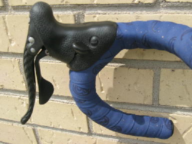

    For those of you who have reach issues to the brake levers I've found 2 handlebars that might be worth checking out. Both are designed to bring the hand closer to the brake lever which is still an issue for those of us with Campy brifters. Both bars have a flat spot in the bend which allows the hand to get closer to the levers.
    TTT makes the Eva. It comes in sizes 38/42-40/44 cm. Its made a little wider at the bottom.
    The Modolo Venus comes in sizes 34-42 cm. Looks like it has a 77 mm reach between the lever and the bar.
    The disadvantage of the bars is that newer bikes have larger clamps so a new stem will probably be required.
    I looked at the Poco bars but the little bump restricted my hands so my fingers wouldn't reach the brake levers.
    I ordered the Venus because I need the size 34 cm. I'll give a report on it when I receive it.
