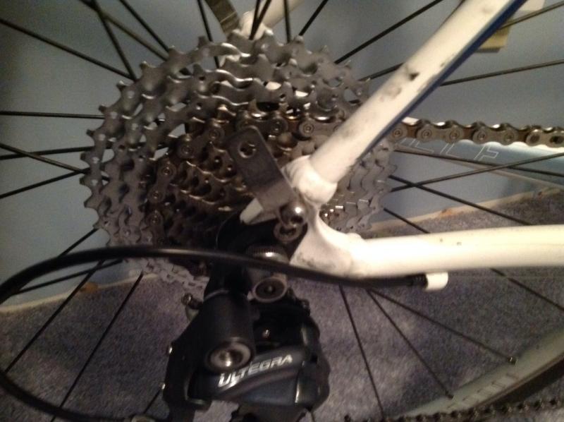

    I had to go to three different LBS.The first two shops tried talking me out of it and or telling me how difficult the change over would be and how it would mess with the engineering bla bla bla, how "difficult" getting the right parts would be. You get the drift of the conversations I had with the first two shops?. It was frustrating however I knew what I wanted and I also knew it could be done, so I went to LBS number 3. The third shop....wow...huge difference. Not only did the male employee listen to me he actually had a few ideas that turned out to be pretty useful. Plus set aside his current work and worked on my bike right then and there. Within an hr he had made all the adjustments and changes. I was so pleased I could of kissed him. I got a new cassette, derailleur, and a new chain. Since it's been pretty cold and icy this last week I have yet to get out for a ride and see how things work going up hill, I'll post when I do.

    Third time's the charm! I hope the changes get you up those hills more easily.
