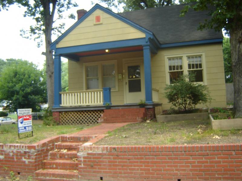

    I'm purchasing a house that needs a little work. Not a lot, but enough to make me think about things. I want to do it right to balance cost, energy efficiency, and quality. I'd like to do things as green as possible, within reasonable cost.
    The Facts:
    1. The house is a 1939 bungalow; 900 SF. I live in Richmond Virginia, which is hot in the summer and can get downright cold in the winter (we even get snow sometimes, but more often ice).

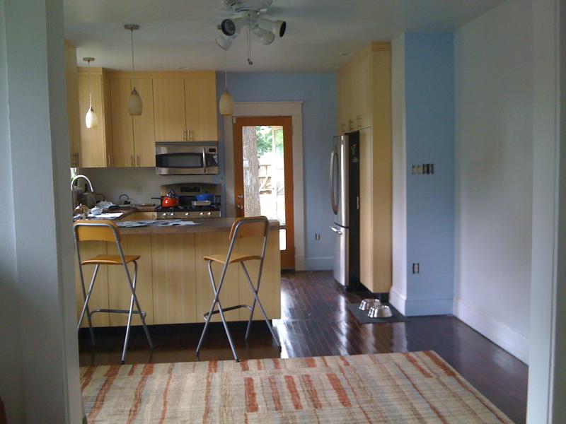

    For me one of those things was that I wanted the kitchen sink centered on the window. The old one was not, the angle just seemed odd and when I washed dishes it bothered me.
    I like to be able to look out the kitchen onto green space of some sort even though right now it's only a tiny patio. Here KnottedYet is enjoying the space.
    I also wanted a pull out cutting board. Such a simple thing, but very glad I have it. What can I say, used to be a prep chef, I like to chop and dice stuff. More cutting boards more better
