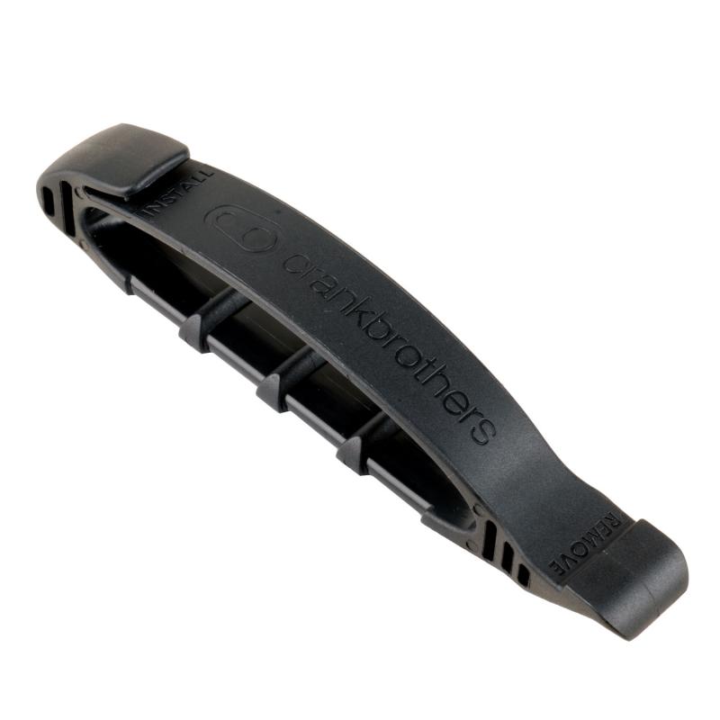

    LBS just recommended this gizmoClick image for larger version.
ID:	17014, so I bought it, and will have to see whether it actually works. It's supposed to make it easier to get the tire back on the rim.
    I also hope I don't have to try it out for a while. Still feeling traumatized at the memory of Sunday's adventure.
    Feb 2012
    Toronto
    93
    Got another flat -- second in four rides -- and the gizmo helped a little. I did manage to fix the flat the first time, and a group of fellow riders showed up just as I was finishing and offered moral support.
