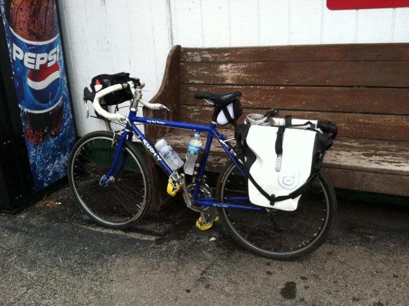

    I'm 5'4" and ride a 46cm Surely LHT. Get a fit done if possible Surly fit is a large feeling. I think I would ride a 48-50cm in a regular road bike.
