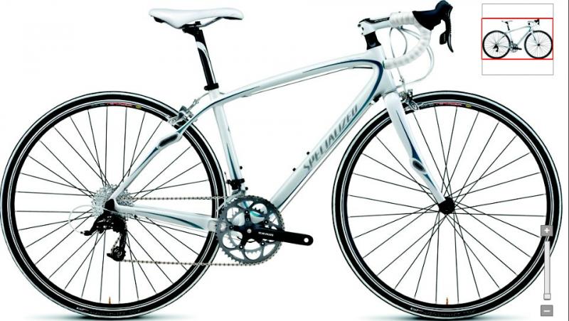

    If your seat post has the "pave" clamp like on my 2011 Ruby Elite below, it will have two bolts. One is normally in the back and is easily accessible - it might be replaceable. The 2nd bolt is directly under the saddle and is barely accessible since the large serrated bolt head is situated between the saddle and the top of the clamp - this bolt may be hard to replace.
    I was unhappy enough with the "pave" clamp seat post that I looked around for a replacement, but I couldn't find a zero-setback seat post within my meager budget.
