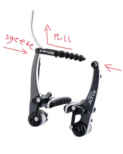

    On one side of this "accordion rubber thingy" the brake-cable goes through a metal clamp. If you pull the rubber thing back a little bit and squeeze the two arms of the brake together, you can normally see where you can get the cable out.
    You have to squeeze the arms together with one hand and then pull the cable outwards and up to come out.
    It's hard to describe but easy to do...
    Ok maybe my limited Photoshop skills will help (I forgot the "u" in "squeeze". No, I won't write it again.)

    Ok, I had the right idea at least I didn't know how much I could pull the rubber thingie.

    "sgeeze" = yes. always this.
    Your photoshop skills bring me joy. The laughter of a child. But how sweet of you to help with a diagram, really. That's so nice.
