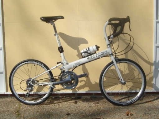

I don't know that there is a good bar end shifter "option" on the website (which even BF acknowledges as a mess right now). However, our rep was able to order them for us (and they're quite a bit less expensive than STI for what it's worth). Or, was that the question?
The drop bars split in 2 and sort of nestle around the bike in the suitcase.
Yes, I don't recall even seeing bar-end shifters as an option, but the salesguy we worked with (Walter, who is no longer in sales) suggested them as being the best functionally with V-brakes, since I wanted the mountain gearing in the back. If you don't go with mountain gearing and v-brakes, there's no need to get the bar-end shifters, and I'd probably go with STI if that is what you are used to.
I do like the bar-end shifters a lot, but they do require moving your hands around on the bars more, and every now and then I'll hit my leg on one of the shifters. But they work very well with the setup on my bike.
As for the drop bars, they can get you any bars you want that can be cut/split in two (i.e., no carbon bars). So if you have a favorite handlebar, they can get them and split them for you. I had the Salsa Pocos on my other road bike at the time and liked them a lot, so that is what I ordered. Note that you will lose about 1 cm in width when they split them, so if you are between bar sizes, order up.
